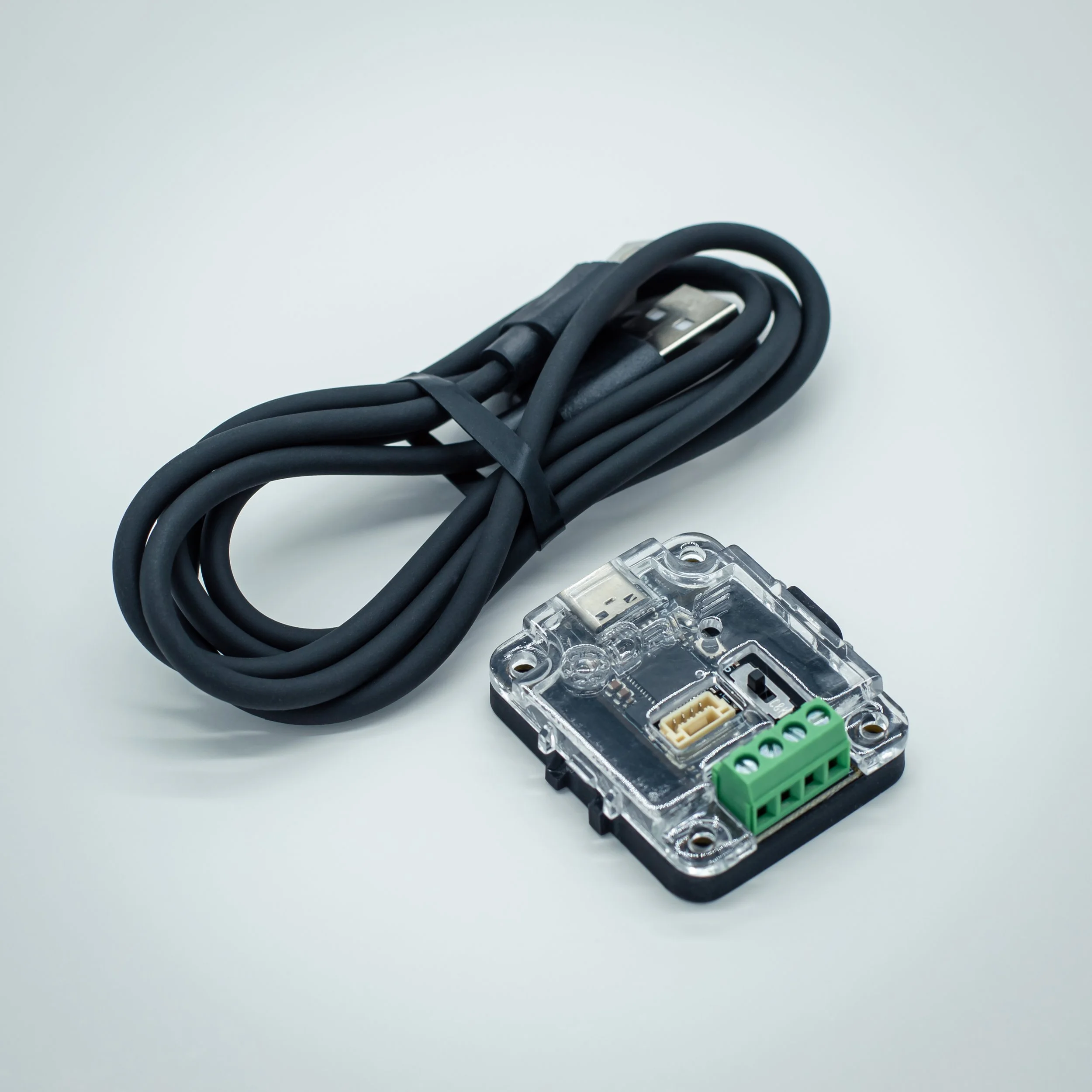

A plug-and-play USB to CAN adapter, perfect for controlling ODrives and any other CAN devices.
Shows up as a native SocketCAN device in Linux
Support for Windows and macOS via Python
Supports CAN 2.0B, up to 1Mbit/s
Easy connection to a JST-GH CAN Cable
Screw terminal for flexible wiring
Onboard termination resistor (user-selectable)
Included case for protection and ease of mounting
Indicator LEDs for device status
Future support for GUI and odrivetool over CAN Bus on Windows, macOS and Linux (coming Q4 '24)
Protection against reverse polarity and overcurrent
Protected 5V feed into CAN bus
Comprehensive ESD protection
