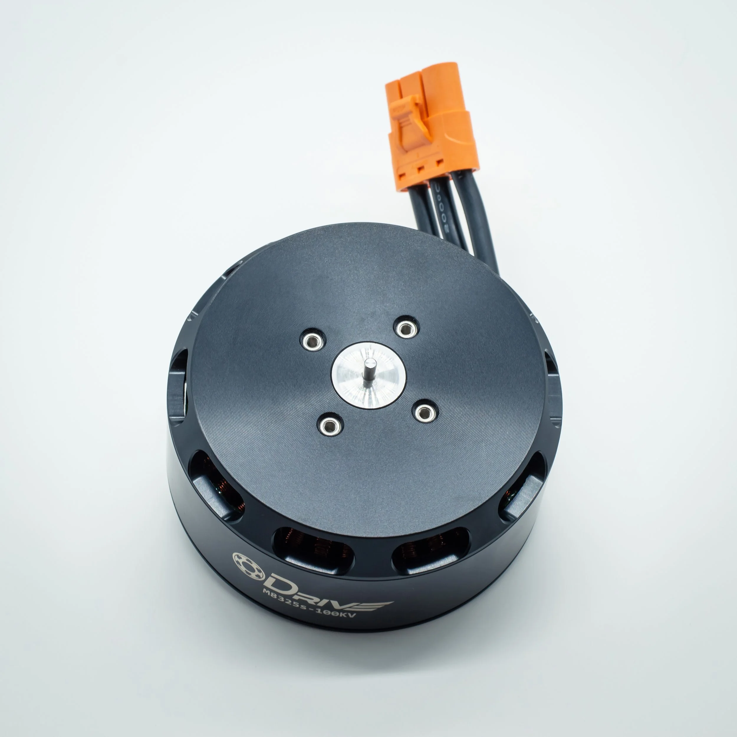

This is the highest torque motor we sell, in a "pancake" form factor — great for wheels, robot arms, turntables, or anywhere else you need some power! Plus, the included shaft magnet allows for easy integration with any magnetic encoder.
Use the ODrive Pro or S1's on-board magnet encoder by mounting the ODrive directly on the back of this motor, using the Motor Mounting Plate, and regular heatspreader or enclosure.
This motor comes in two variants — one with LCC40 connectors (compatible with the LCC40 motor power cable and ferrule adapter), and the other with bare, pre-tinned wires for soldering to your choice of connector.
Note the M8325s is designed to transmit torque through the the face of the motor shell (via the M3/⌀31mm bolt circle). The small locating pin is strictly for centering your pulley / gear / hub / etc, and not intended for transmitting torque.
Comes with 4x flat head M4 10mm Torx T20 screws.
KV: 100, Diameter: 92mm, Weight: 840g
20 pole pairs
Mounting plane to top plane: 46.5mm
Top locating pin diameter: 3mm, height: 6mm
Mounting pattern: M4 on 40mm diameter circle
Top side hole pattern: M3 on 31mm diameter circle
Compatible with Motor Power Cables LCC40.
- Bare wire: M8325s
- LCC40: M8325s_2
